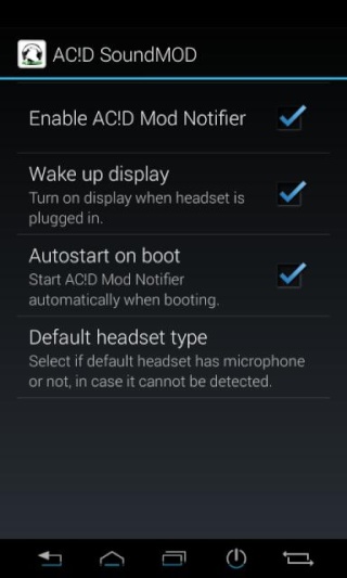

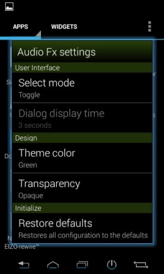

★ Monster Sound with Sony files/beats files and my files
★ Screenshot (enable via Rom System Control)
